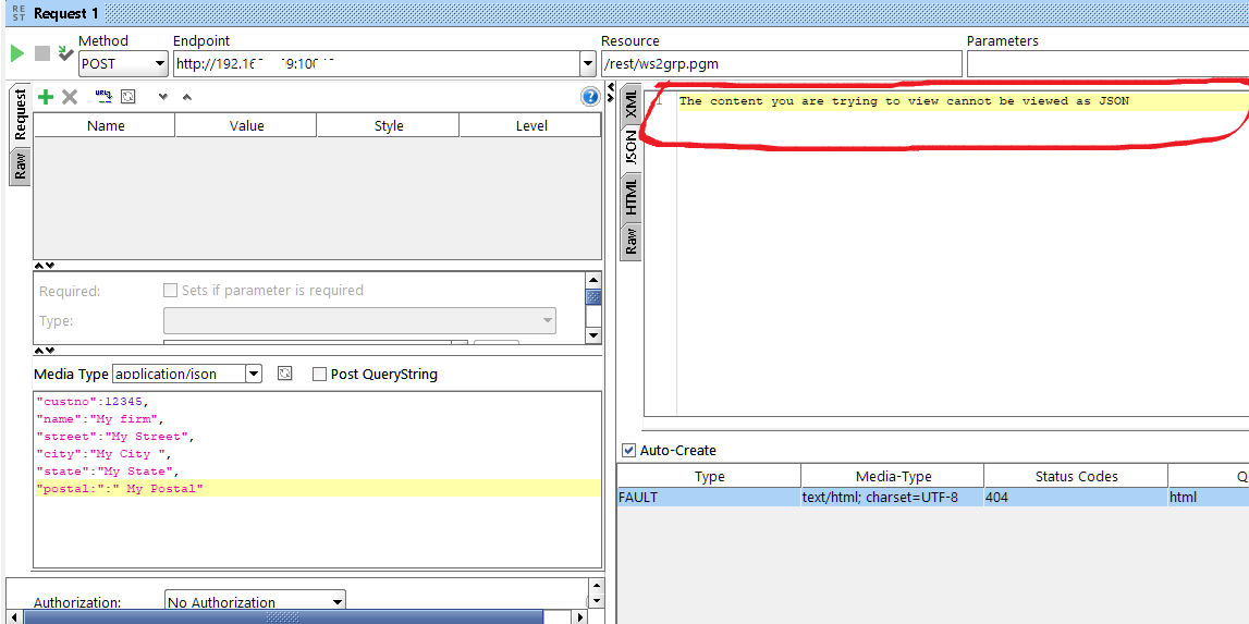

and now i would like to test it using SoapUi or Postman, but
with Soap Ui
i receive the error that you can see at img01 attacched , and the program in not called

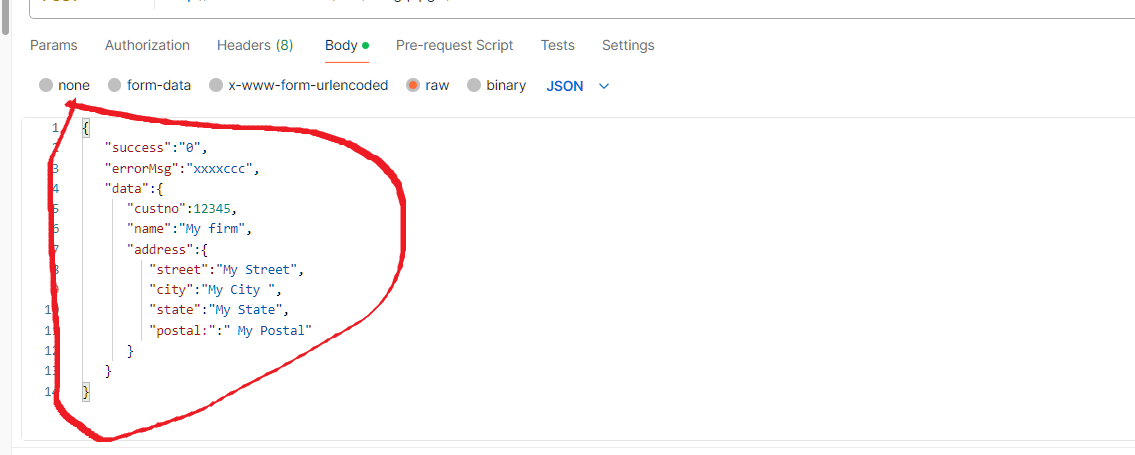

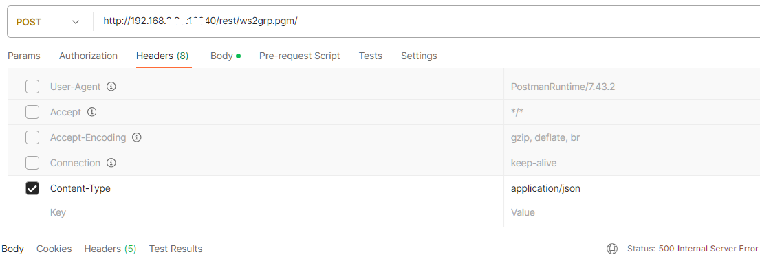

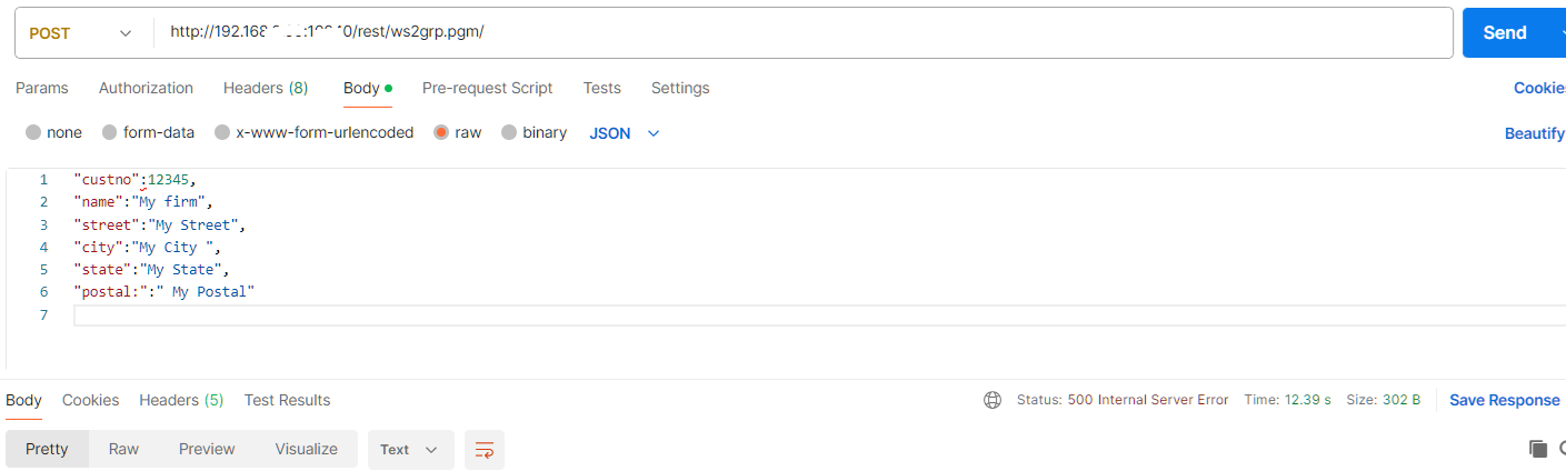

with PostMan .. see img02, the program is executed, but the data-into go on error and so the DS cust is empty
can some , show me how to configure the web service invoke with Postman or SoapUi ?

Hi
solved .. the Json was wrong
in postman i tried with this Json and now it works
Gio
