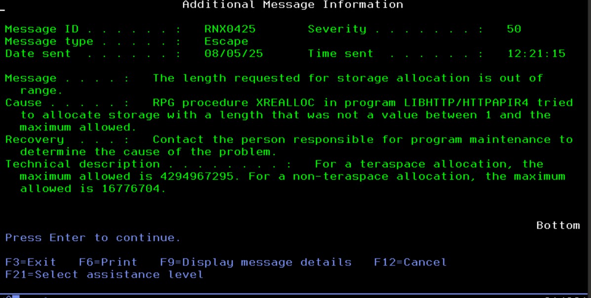

I am attaching a screen shot of the error I am getting.
Does this have to do with the XmlReturnPtr feature you mentioned? How can I tell if we are using that?

The HTPPAPI is cashing because the value in one of the of the nodes/fields can sometimes be too large. When this happens, I can delete the node and the .xml process fine.
It is not crashing because the .xml file is too large, rather it crashes when a field/node has too much data.

Did you code it? Are you calling the http_XmlReturnPtr() subprocedure?krkatz12 wrote: Fri Aug 08, 2025 5:26 pm Does this have to do with the XmlReturnPtr feature you mentioned? How can I tell if we are using that?

The document you provided is not a well-formed XML document. As such, in order to try to do anything with it, I have to modify it.
I simply enclosed the whole thing in <xml> and </xml> to make it a valid XML document. Then I tried having HTTPAPI parse it, and it did so without any error -- it worked perfectly.
Obviously the <eBig.11> element is larger than 32k, so only partial results are returned, which can be solved by using http_xmlReturnPtr(). I asked you about this in the previous message, but you didn't answer the question.
But, at any rate, its not failing for me. And you clearly didn't try the document that you've provided here, since it's not even a valid XML. Please -- my time is valuable, and I'm doing this in my free time. Either make sure what you provide will demonstrate the problem, or else consider hiring me on a consulting basis to help you.
