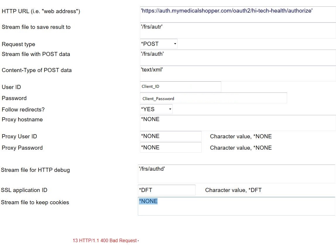

I create manually the document:
POST /oauth2/hi-tech-health/authorize HTTP/1.1
Host: auth.mymedicalshopper.com
Authorization: Basic credential in base64
Content-Type: application/x-www-form-urlencoded
grant_type=client_credentials
Trying to *post the request and I had 13 HTTP/1.1 400 Bad Request
HTTPAPI command
HTTPAPI command
Capture 00.JPG (120.84 KiB) Viewed 103340 times

This is not a document.
The start of it (POST, Host:, Authorization:, Content-Type:) are part of the HTTP protocol. You should never be doing that manually unless you are writing your own HTTP software.
The last line "grant_type=client_credentials" looks like a part of a URL-encoded form, but you've put it in the headers instead of in the request body, so 100% of the time this will generate a "400 Bad Request" response -- because it is not valid to put it there.
Start by deciding if you want to do it all yourself manually, or if you want to use HTTPAPI. Also decide the requirements for what you need to do with base64. If it is Basic authorization, you don't need to code that yourself, just use http_setAuth
