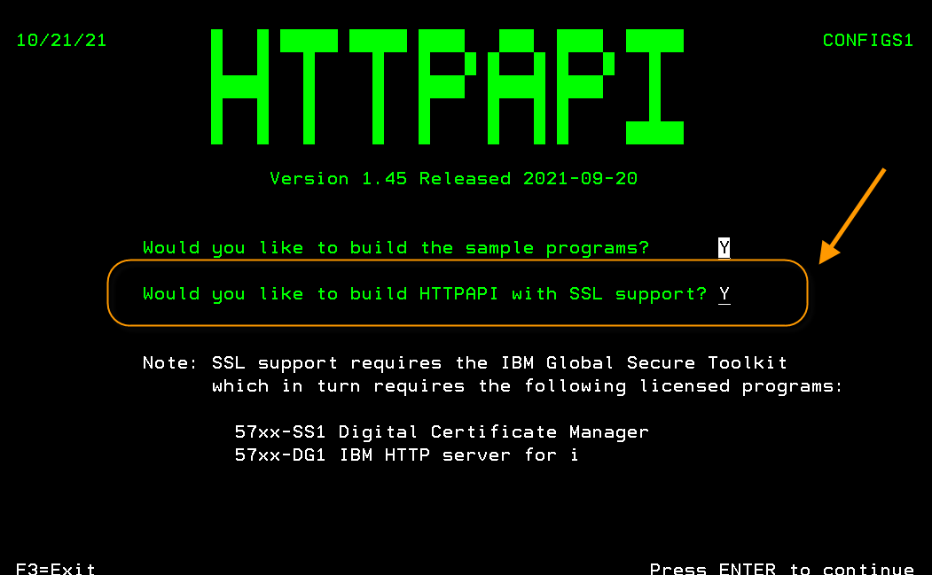

You are using a version of HTTPAPI that is 11 years out-of-date. Please consider updating it.
It sounds to me like you're trying to use a URL that begins with https://? This is fully supported in HTTPAPI, but when you compiled it (back in 2010!) you did not compile support for SSL into the product.
Please download the latest version and compile it with SSL support included.

I have the same error "Only the http protocolis available!" in log. I have set SSL support to Y during installation? Is the digital certificate needs to be setup as well? Please help and thank you in advance.

slumbera wrote: Tue Jan 11, 2022 9:59 am I have the same error "Only the http protocolis available!" in log. I have set SSL support to Y during installation? Is the digital certificate needs to be setup as well? Please help and thank you in advance.
If your digital certificates aren't set up you'll get a completely different message.
This particular message means that you didn't compile support for https into HTTPAPI. If you truly recompiled HTTPAPI with support for SSL enabled, then perhaps you have a different copy of HTTPAPI in your library list?
