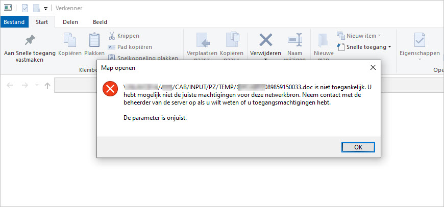

All of a sudden we have a problem with STRPCCMD when trying to open a Word document. This forum is my last hope for a solution.
Analysis
When this code is executed the users get the error shown in attachment.

Re: STRPCCMD gives MS explorer error
I don't speak Dutch, so I ran the error text through Google Translate. I hope this is an accurate translation
You may not have the correct permissions for this network resource. To determine whether you have access permissions, contact the server administrator. The parameter is incorrect.
As far as I can tell, Windows is having trouble opening the network resource. Perhaps it is taking a long time to open, so inserting a 10 second delay is solving the problem for you?
At any rate, this isn't a problem with your RPG code -- the problem is 100% on the windows machine.

Scott Klement wrote: Tue Sep 19, 2023 5:41 pm I don't speak Dutch, so I ran the error text through Google Translate. I hope this is an accurate translation
Apologies, you're right I forgot to translate. And a free tip, https://www.deepl.com/translator is far more better then google translate ;)
