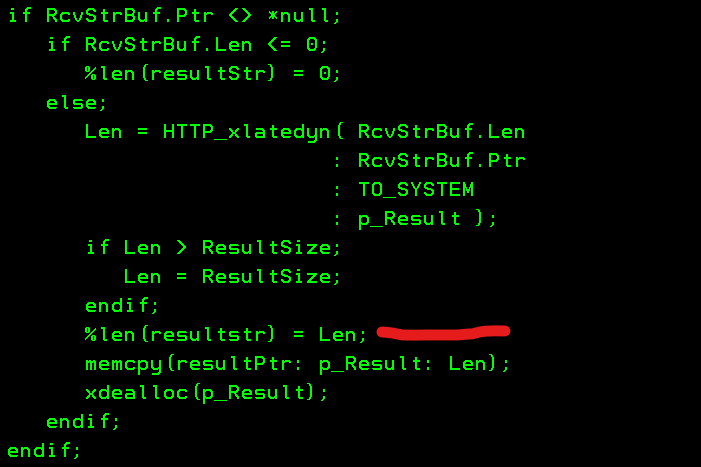

Performing a debug, the stop with error occurs in: HTTP_req(): in the line:
%len(resultstr) = Len;
Since it doesn't reproduce in all cases, I don't know if it's an API problem.

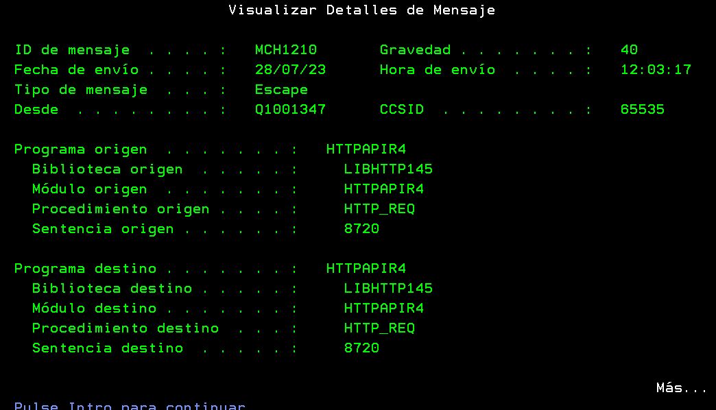

With your idea of ​​the new LIBHTTP145 library, I have installed the latest version.
Until today I had never done this, since colleagues who are no longer in the company did it.
I have performed new tests with HTTPAPI version 1.45 and the error continues to appear.
I attach the log for your information.

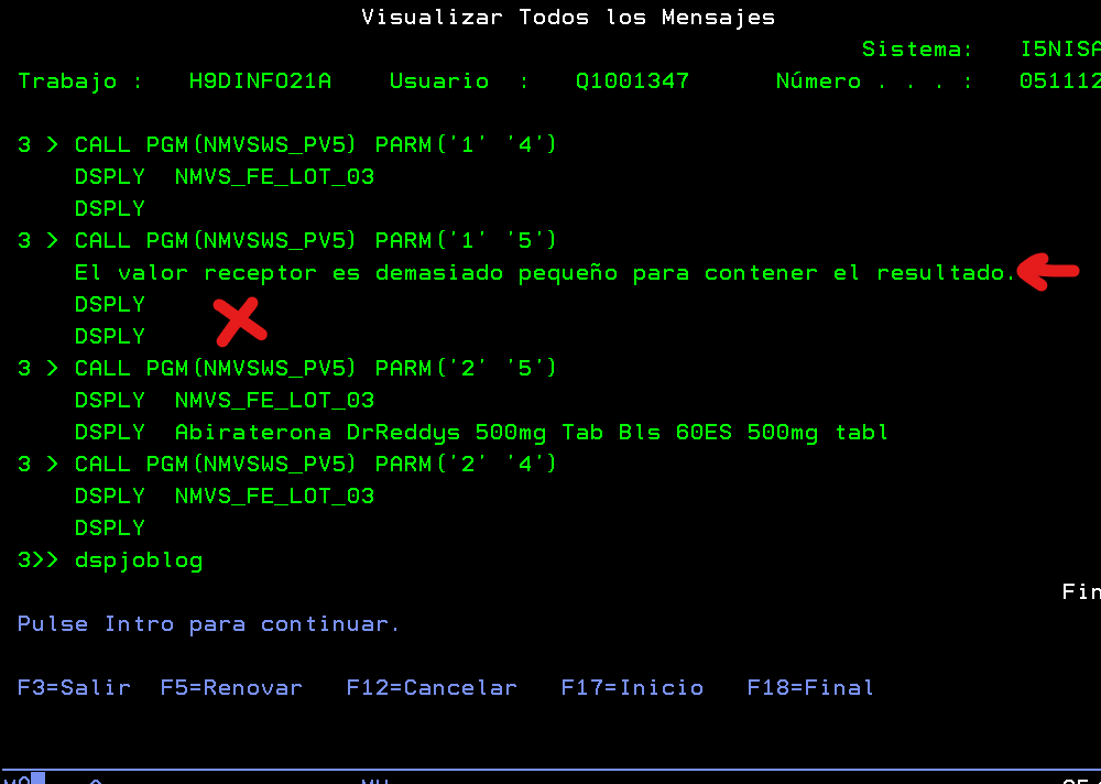

HTTP_SetCCSIDs(1208 : 0);
I don't know if it will work, but doing DEBUG on the image source, the LEN field is = -1
In the HTTPAPI_H source, in the HTTP_xlatedyn section I have been able to read: it returns the length of the translated data or -1 in case of failure. But I don't know what error it is.

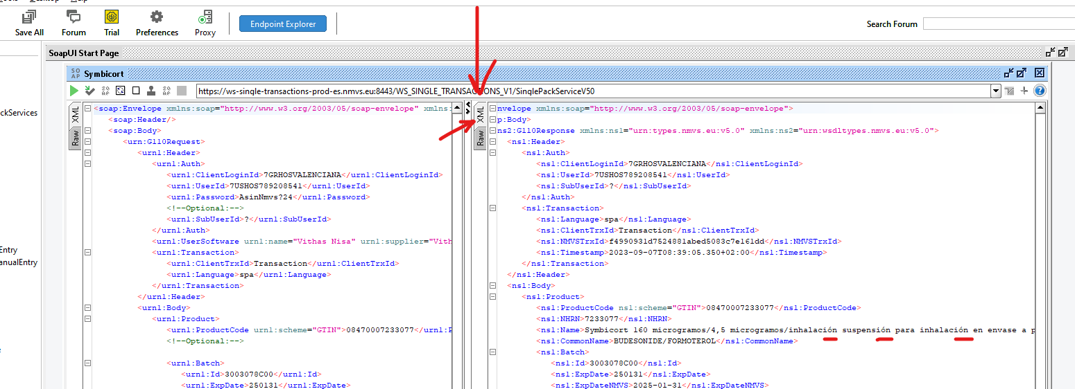

Finally, I am observing in the logs sent, in the last part, that the XML response issued by the
SEVEM entity, but this response is not received by my program, after giving the error. It only comes to me in white.
In the AS400 with DSPJOBLOG I see the error that you see in the attached image.
Thank you very much

Re: SetError() Ñ73: CCSID conversion failed
HTTP_xlatedyn is returning -1 because there is a character it cannot translate. I can fix HTTPAPI to not crash when this happens, but it won't change the fact that there's a character it cannot translate... you need to determine what that character is and figure out what you want it to do with that character...

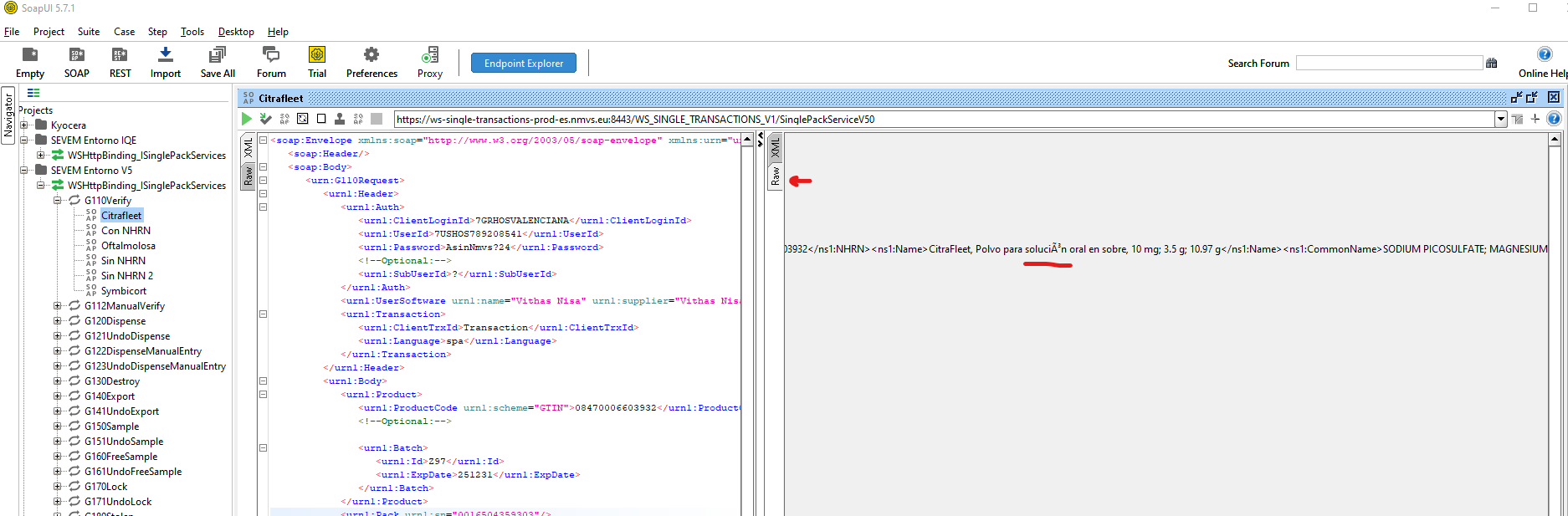

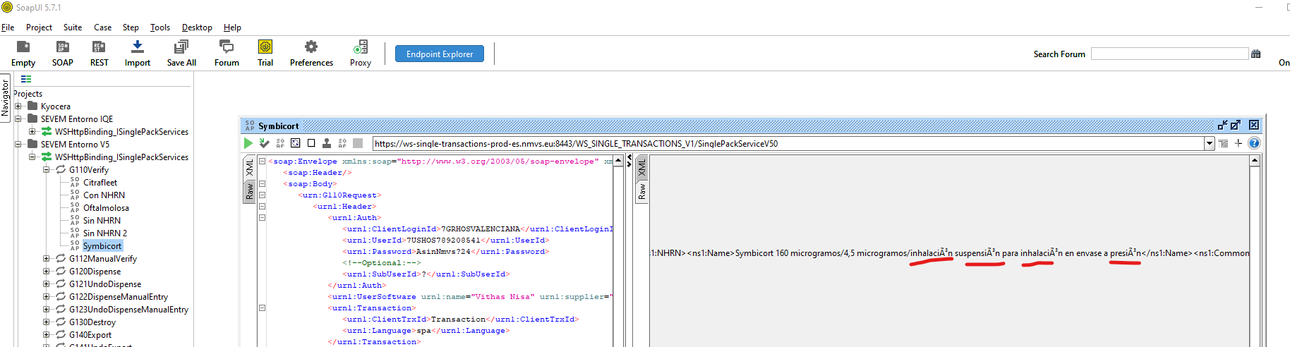

Reviewing the HTTPAPI log, I don't see any strange characters in these responses that are sent to us. I only see an accent, but I don't think it's the error. What I really want is to show the response as SEVEM responds to me in its Web Service.
I don't know how to manage it.
