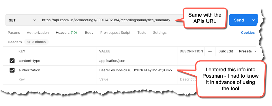

Just as an example - I use the Zoom APIs - they require that I supply a JWT as a Bearer token. It is passed as a header via the http_xproc API. In order to code this Zoom had to tell me that a) It had to be an "authorization" header and b) That the type was to be "Bearer". THAT is the info you need - and you would need it for Postman or Insomnia or ....
This is the header I use - it is created by calling my own GetJWTKey API and appending the key to the 'Bearer ' keyword.
authorization: Bearer eyJhbGciOiJIUzI1NiJ9.eyJhdWQiOm51bGwsImlzcyI6Ii1uQ1Y3cTRRU2FPWkVTUXdSTnFoc0EiLCJleHAiOjE2NjE3MDY0OTIsImlhdCI6MTY2MTcwMTA5Mn0.CX1YY3PKMT_wTxzolhMKmKkEjBTkwF59s3CJk9P7pLs
And to set that I use http_xproc to register my header routine and then when httpAPI calls my routine it just adds the data.
authorizationToken = 'Bearer ' + GetJWTKey();

Paul ... Postman is a TESTING tool. You use it to check that you can connect to a given web service. I don't use it much so I can't be certain, but most tools in this arena require _you_ to supply the key as I did in this example of manually using Postman to make the same Zoom API call I described before.
As to your question - nobody can answer that until your API supplier tells you how to authenticate. Try asking them for a Swagger file and import that into Postman that should show you.

Jon's screenshot shows a more typical looking bearer token.
You shouldn't need to do that "special headers" stuff that he's doing unless you're on a very old version of HTTPAPI. Current versions allow using http_setAuth just like your example.
