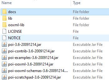

Also, do I need all the folders from the 3.6 version or just the main folder to be there (e.g. lib, docs, ooxml-lib)? I've attached an image of the folder I downloaded.
Thanks again.
Thanks again.

I don't think you need anything from those directories, but as I mentioned before, I have not used this stuff in more than 10 years -- I don't remember what's in those directories.
