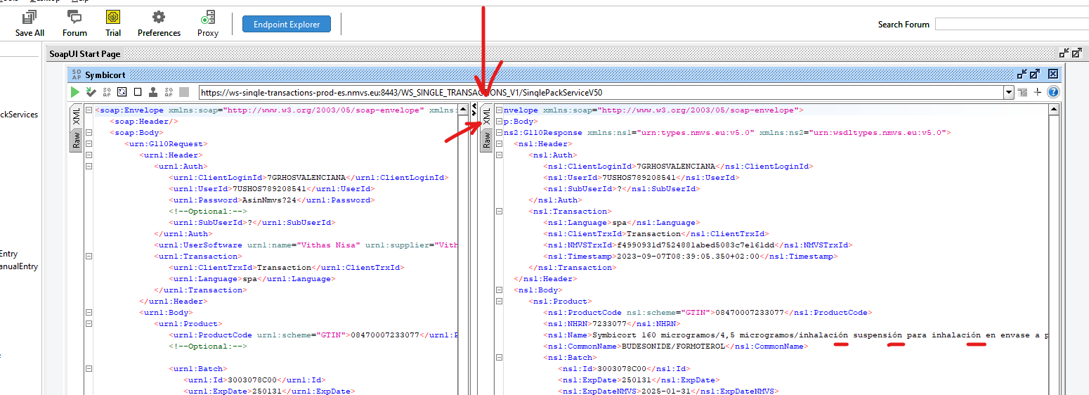

For contributing something else. I have carried out tests with SOAPUI software, to see if the answers had any common ground. Indeed, seeing the response as RAW, in the cases that this error occurs, it coincides that there is a word with accents (see images). I don't know if it could be the reason for this error, and the program would have to be parameterized in some way when using the API.
Re: SetError() Ñ73: CCSID conversion failed
Posted: Wed Sep 06, 2023 4:53 pm
by Scott Klement
As you can see, these characters aren't represented correctly in SoapUI -- it is showing as several garbage characters rather than a single proper (accented) character. So something is wrong with the way the data is encoded.

However, it does display correctly in SOAPUI in XML format.
Based on your experience, should I contact the entity that provides those WS?
Tks
- Example SOAPUI XML (no RAW).png (89.11 KiB) Viewed 26586 times
