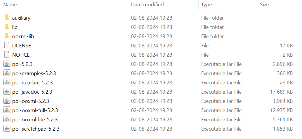

Where did you get all these jar file. I am getting jar files as you can find in attachment. would it be same or not?
[img][/img]

I wrote this stuff for a previous job many years ago. If you want to take the code and update it to work with 5.3.0 you certainly can, but it'll be up to you to identify the things that need to be change, change them, test them, etc.
I know it works with version 3.8.
You should be able to get any release from the POI website... I just went there now and clicked through and it took me to this URL. It looks like it has the poi-bin-3.8 (and poi-bin.3.6 versions) amongst other things...
https://archive.apache.org/dist/poi/release/bin/
