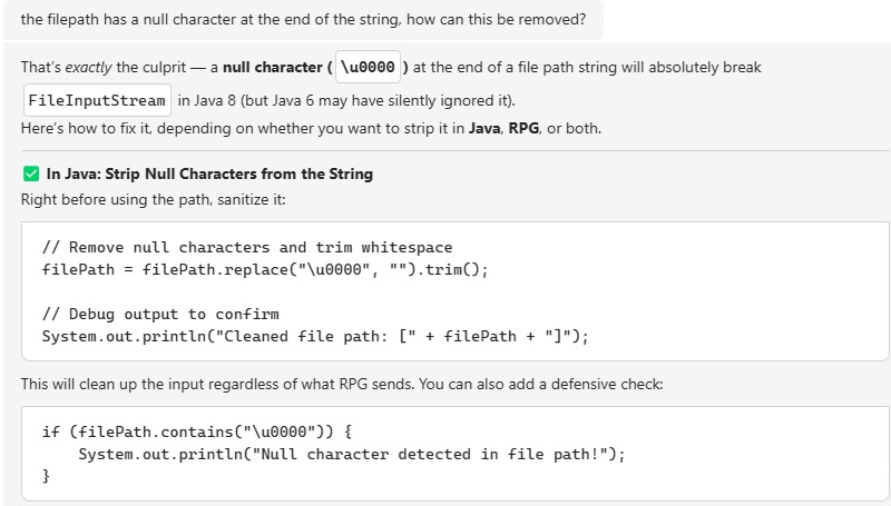

We are upgrading our system from 7.2 to 7.4. We are using Java 6 on 7.2 which is not supported on 7.4. When we update the java path to Java 8 the SS_OPEN fails using HSSF to open excel an excel file. This works fine with Java 6 but fails with Java 8.

No matter what we try the open still fails with Java 8 with this error.

Cause . . . . . : RPG procedure SS_OPEN in program HSSF/HSSFR4 received Java
exception "java.io.FileNotFoundException: Invalid file path" when calling
method "<init>" with signature "(Ljava.lang.String;)V" in class
"java.io.FileInputStream".

Resolved:
Found this on google, someone else had a similar issue:
