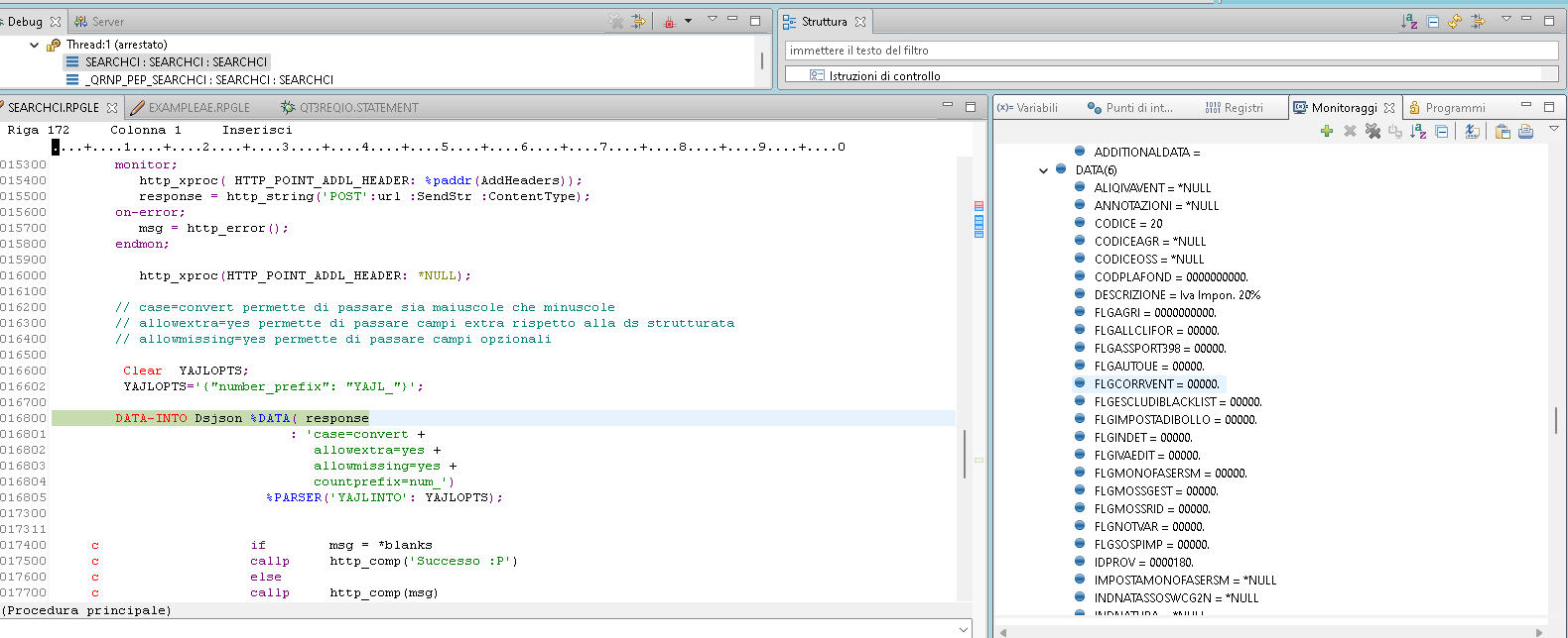

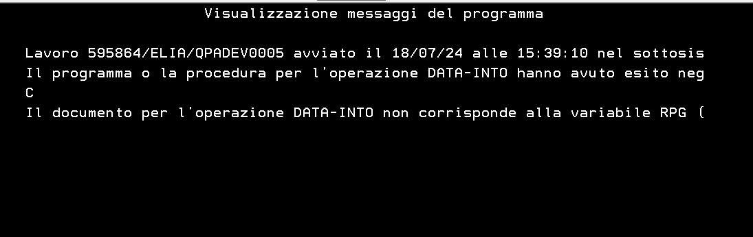

I get this error
But the DS is perfect up to Data 6; from the next record, the DS are empty.
What can I check?
Screenshot 1.png (59.18 KiB) Viewed 29101 times
Screenshot Error.png (8.75 KiB) Viewed 29101 times
Re: API call with Headers
Move the cursor to the error message and press F1 to get more details about what the error is.
Most likely it's mapping data to the DS until it gets the error, then stops -- so you have only a partial one filled in.

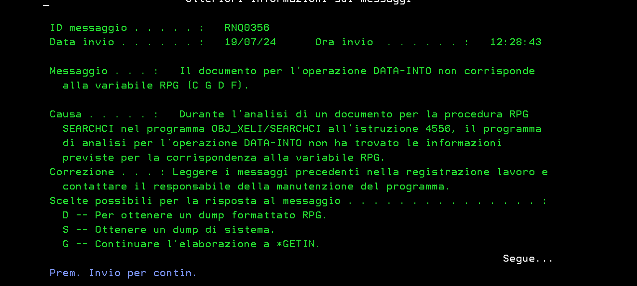

Scott Klement wrote: Thu Jul 18, 2024 4:08 pm Move the cursor to the error message and press F1 to get more details about what the error is.
Sure, this is clear, but I don’t know what else to check to understand the problem.
Screenshot error1.png (21.59 KiB) Viewed 29095 times
I don't speak Italian. What does the message say?
