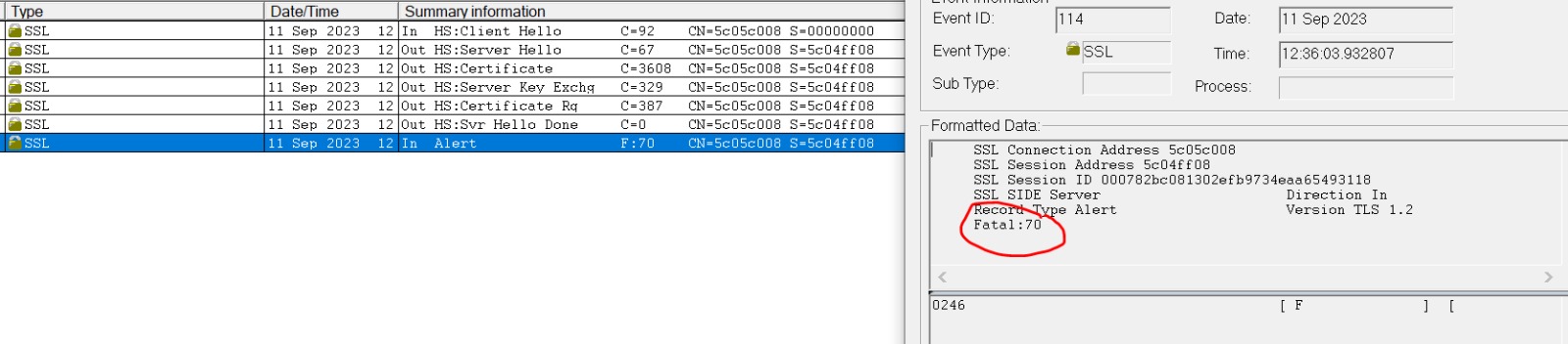

From destination server (TCP Server)'s handshake log, I could see that iSeries (GSKit) is sending TLS 1.2 and valid cipher suites in Client Hello message. And server pick up TLS 1.2 and one cipher suit in Server Hello. But during handshake, after Server Hello Done, the client site alert Fatal:70 (Protocol Error).

richardchen wrote: Tue Sep 12, 2023 3:01 pm From destination server (TCP Server)'s handshake log, I could see that iSeries (GSKit) is sending TLS 1.2 and valid cipher suites in Client Hello message. And server pick up TLS 1.2 and one cipher suit in Server Hello. But during handshake, after Server Hello Done, the client site alert Fatal:70 (Protocol Error).
I'm not familar with the tool you're using or what "70 (Protocol Error)" means. However, I suspect it means the same thing as the 410 code you posted earlier. So this doesn't really tell us anything we didn't know.
